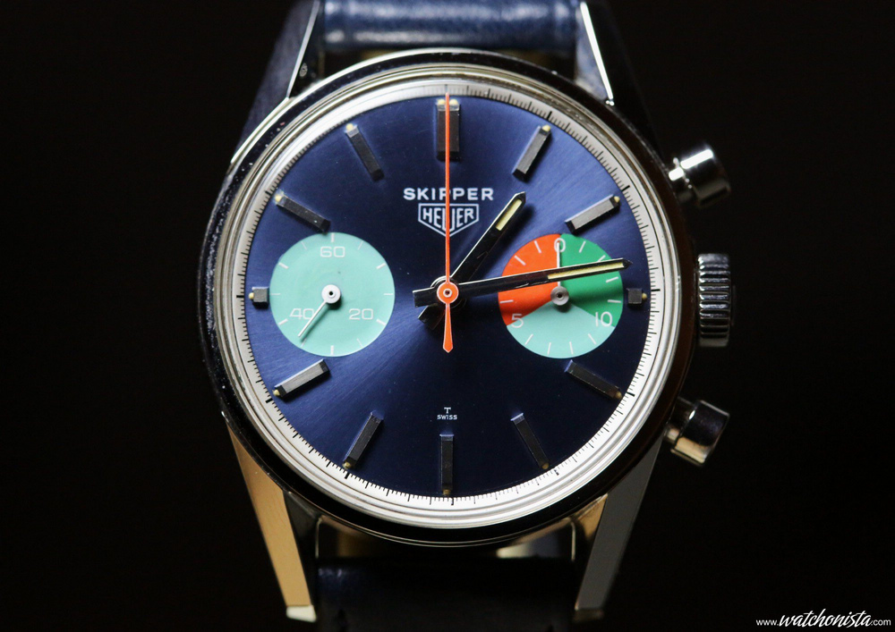

Heuer Skipper 7754 竄 Skipperera 罈
Another model which is slightly off-beat but very much iconic of the creative medium that defines this series is the Skipperera. The Skippers are a bit difficult to classify in the Heuer lines, as they are sometimes Autavia and sometimes Carrera. Experts air varying opinions about it
As far as the aptly named Skiperrera presents a Carrera case, one can consider that it is a full Carrera.
The interest of this watch lies in its aesthetics. It neither distinguishes itself by its case, which is the standard version of the Carreras, neither by its calibre, a Valjoux 7730.
However, before focusing on the dial, it is useful to linger on this calibre a bit. The Valjoux 7730 is a calibre of manual chronograph having a frequency of 18000 vibrations per hour for 45 hours of power reserve, it measures 31mm on 6, that is, almost the same dimensions as the Landeron 189.
One will note that at the time, the size ratio of the caliber/size of the case was different from that of today. Back then, like sports cars motors, big calibers were cased up in small cases, at shoehorn.
What makes the particularity of this 7730 (which is probably the reason for his choosing this Skipper) is that it offered the possibility to display 30 or 45 minutes on the sub-dial at the 3 oclock position. And here, Heuer had driven this function into a corner: by modifying a wheel, it was possible to display only 15 minutes by thirty jumps of thirty seconds.
Why is that? The answer is, as always, that it was for this famous countdown of the regatta launching. One will equally note that the minutes timer is graduated in the inverted direction: it is launched 15 minutes before the regattas start, the last third indicating the warm-up of the event.
However, the main interest of the watch does not concern the above but rather the dial, which is one of the most beautiful that I have ever held. The dials from that epoch are of a great quality and are no less appealing than the current productions. The reliefs are qualitative, the textures very clean and above all they grow old in a very good way, of which the good quality of the epochs lacquer is proof.
The colour scheme of this Carrera 7754 is perfect: night blue, almond green, orange, in ideal proportions. In a visionary way, it synthesises everything that was best made in sports and summer dials of the next 40 years. Night blue for looking good, orange for relaxation and almond green for nostalgia.
Moreover, the very streamlined context of the Carrera (white railroad, index and simple hands) further highlights the colour scheme.
The collectors are not wrong; it is approximately quoted the double of a Carrera from that time, often as from 7000 CHF.

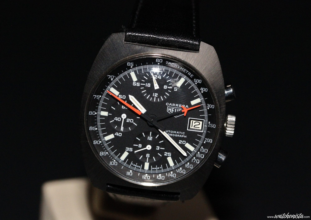

Heuer Carrera 竄 Automatic 70 罈 110.253, C繫te de Gen癡ve
Directly moving on to the year 1978, we will interest ourselves with the Heuer Carrera 110.253 since the latter joins numerous emblematic elements of the 70s Carrera.
The first major change was the case: it became barrel, was enlarged by 2mm and lost its long horns, very characteristic of the 70s. For the purists, it is undoubtedly slightly shocking; so much as this model distanced itself from the 60s models. However, in opposition to a Daytona, which is monolithic by vocation, it is a laboratory; it is thus legitimate that its creators attempted to change the shape of its case.
From a personal point of view, I prefer the 60s case due to the fact that its streamlining seems completely achieved to me. Here, the case is very sympathetic, very funky but slightly clumsier than the one from the 60s. While the 60s case was the avatar of Jack Heuers modernism passion, the 70s case ensued from a simplification wish of a case already very streamlined, of postmodernism all in all Consequently, the case called automatic 70 has two advantages: its more solid horns and its superior diameter; as a result, these Carreras seem much bigger on the wrist than their predecessors.
It seems that Tag Heuer has made the same choice for its contemporary watches, in preserving the 60s case shape (this will further be developed at the end of the article).
If the case has been named 竄Automatic 70罈, it must be known that a good deal of the watches it equips are manual!
In fact, the 70s are the time at which automatic chronographs appeared right in the middle of the quartz crisis Between financial and suppliers problems, reliability issues of the automatic chronographs, a great deal of the Carreras from the 70s were equipped with manual movement.
However, this is not the case for this 110.253, which is equipped with a variant of the legendary Heuer Buren Calibre 11: the vintage calibre 12.
The calibre 12 is thus an automatic chronograph with 21600 vibrations per hour, contrary to the vintage calibre 11, with an intermediary frequency of 19800 vibrations per hour. The caliber has a 42-hour power reserve and measures 31mm for 7.7 in width.
It has been nicknamed 竄Chronomatic罈 and the oscillating mass will not be visible on the photos: which is normal since it has been hidden by the chronographs mechanism.
Like the Calibre 11, the vintage calibre 12 is a Buren 1281 with a Dubois Depraz 8510 chronograph module.
Nevertheless, if it is more classic in its frequency, it is also more legitimate: a six jumps per seconds basis is the most legitimate in a sexagesimal time system.
Last detail, the crown has been fitted at the 9 oclock position but the push-buttons (less protruding than that of the 60s models, alas) are in their usual position, namely at the right of the case. The contrary might have been more ergonomic, it seems more instinctive to activate a chronograph with the right hands thumb rather than with the index
On the dials side, like the other vintage Carreras, it is sportive classicism with a touch of madness, the whole served by an execution level which is no less appealing than the most beautiful current productions.
Proof of this? The dial is crossed by three big blue C繫tes de Gen癡ve, very well made, the black sub counters almost break its harmony. In fact, the latters are flat and matt with white indexes. However, despite the beauty of its dial, this Carrera 110.253 is a tool watch, thus the functional aspect prevails.
Besides, the whole of the index/hands remains very classic, polished steel, streamlined design. Priority is given to efficiency.
It is not very hard to find one at approximately 2500 CHF, which isnt much if the dials execution quality and the embedded legendary movement are taken into consideration.

Initially, the Carrera, sports chronograph, was barely derived from classical watches of the 50s. This Swiss style of the 50s, functionalist-but-elegant, was still influenced by the 30s modern art; Swiss people, with their proverbial precaution, are often lagging behind on trends.
Thus, the first Carreras were streamlined; however, in the course of the 60s, these chronographs will rapidly run wild, integrating more and more exotic movements following display needs. Indeed, one of the particularities of the Carrera series is indeed to have adapted displays and movements to the needs of the final users.
Thus, instead of just producing railways or bezels dedicated to a specific usage, Heuer has often reviewed the whole mechanics to better adapt to needs.
To that effect, Heuers quest was to adapt the tool to one need, rather than asking the human to adapt themselves to one tool. Nowadays, it would be termed as 竄 user-friendly 罈.
The dials equally benefitted from a great variety of finishes and styles, always in view of adapting oneself to the final users needs. However, it is also in the will to adapt oneself to another human need: the taste of beauty.
This aesthetic will is also found in the cases; the first case of the 60s unquestionably remains the purest: at the time when one knew how to make cases, which appeared very fine while the movements were relatively thick. Later on, aesthetics was given privilege over fashion; today, solidity is privileged
The Carrera history is so rich and complex that it merits a book. These watches consist of an almost-exhaustive catalogue of mechanical sports timing in these past 50 years. Thus, obviously, this history is a bit chaotic and the connecting thread is not as evident as it is for other mythical watches. But this chaotic aspect is what precisely constitutes the Carrera range richness, an original soup, an Amazonian forest, a horology culture medium, the founding watchmaking chaos.
