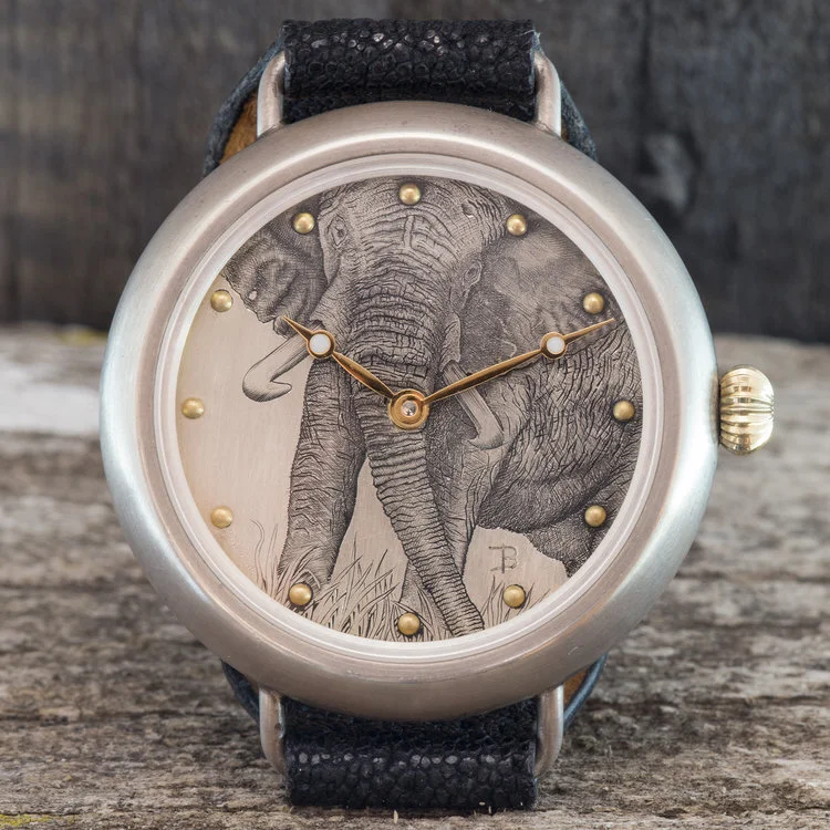

Bulino gravürlü yapılmış bazı saatler
https://www.ablogtowatch.com/panerai-luminor-1950-sealand-purdey-gunmakers-engraved-watches/
https://www.watchprosite.com/piaget/piaget-mythical-journey-part-2-bulino-engraving/881.900053.6158888/
https://hips.hearstapps.com/amv-prod-gp.s3.amazonaws.com/gearpatrol/wp-content/uploads/2013/12/Montana-Watch-Co-Gear-Patrol-Lead-Full-.jpg?crop=0.6701030927835051xw:1xh;center,top&resize=980:*
https://images.squarespace-cdn.com/content/v1/5b71ed055b409b6f787f0a15/1596497839145-LEO5UB5RNHQG8RJ4Z3FC/custom-watches-for-her.jpg
https://images.squarespace-cdn.com/content/v1/5b71ed055b409b6f787f0a15/1593461532177-8DNZHPLWWHI8D6XMA2OT/HA-Elephant.jpg?format=750w
